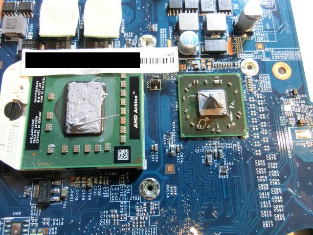

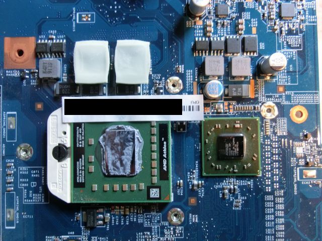

I was also not happy with the noise and heat of the Acer Aspire 5536 and started to disassemble it myself. I have renewed the thermal compound on the CPU. There was also another GPU(?) that had a grey thermal pad on it. However, as I had none available I also used thermal compound to replace as you can see in the second picture.
Before:
After:
I now contemplate opening it again to either change the fan or the whole heatsink. Where could I get those from for a reasonable price?
Alternatively, I could also use a thermal pad for the PU on the left. Does anyone know its size?
What are those two padded elements on the top of the picture?
Thank you for your help.

You have way too much TIM on the CPU and video chip, if that gets all over the MB and associated components you will have all sorts of problems.
See the TIM tutorial provided courtesy of Digerati @ http://www.geekstogo...rface-material/
