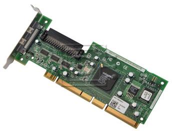

Let's try a different approach. Is the Iomega drive connected to the Adaptec SCSI PCI card?
It will look something like this:
Do you use the Iomega drive? I would suggest disconnecting it (power and data cables) then remove the Adaptec card. See if you can run in normal mode and not have any more BSOD problems.
If that resolves the problem then you can decide if you want to continue using the Iomega drive. If so we need to try to find a newer driver or even reinstall the one you currently have for the Adaptec SCSI card.
