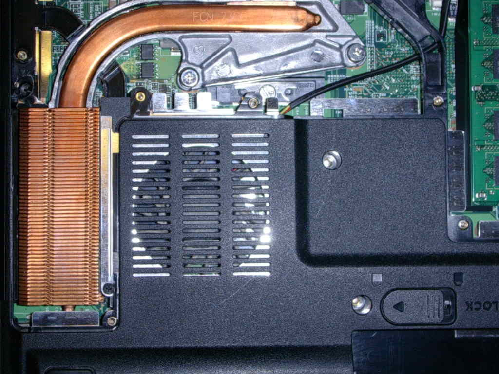

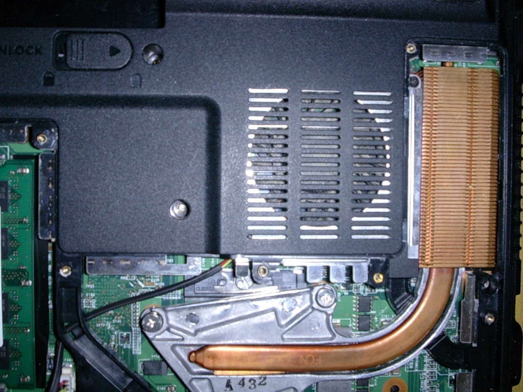

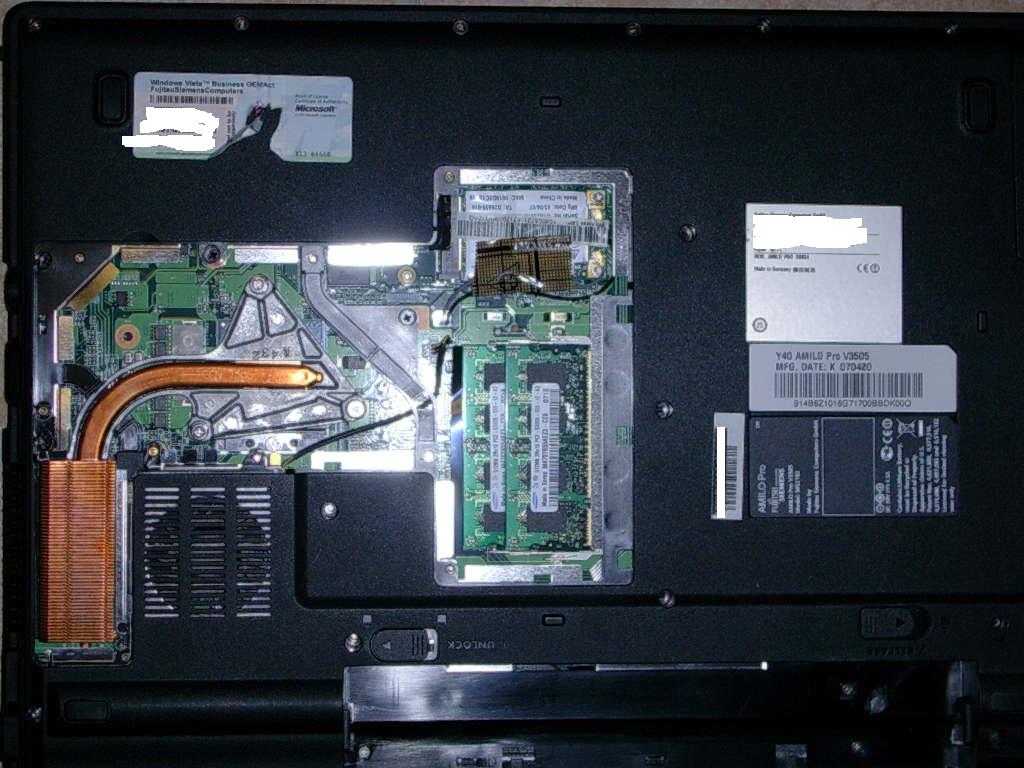

Look at the screenshots, please.

"Use a can of compressed air to blow the dust out." Where the dust is it gone ?

Edited by ramaflore, 16 August 2012 - 04:10 PM.

Inside of system looks pretty good.

It looks pretty good, but fan are dusty, I can see it beyond the grid plastic cover.
