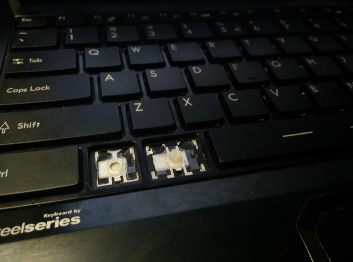

Long story short I dropped a textbook on my keyboard and it completely obliterated my fn key (it's the one to the left in the picture I've attached). The computer is reading the fn key as being pressed down, and this has caused problems because my arrow keys have functions attached to them (volume up and down/brightness up and down).

Hi, is that the keyboard on the laptop?
It does actually look like a separate keyboard.
However, a USB keyboard might be an answer if there is a way to completely disable the onboard keyboard. (Some laptops you can others you can't)
In the interim and providing the keyboard is actually the laptop one, first remove all power and the battery, then with a small screwdriver try and prize out the metal bits of the broken FN key as it is those bits which have shorted, causing the computer to see the FN key as pressed. It won't matter as a repair will be a complete new keyboard any way.

It's the keyboard attached to the laptop itself, I was able to borrow a bluetooth keyboard from a buddy today for some work I had to do so that's been very helpful. Thanks for the tip, I assume you're probably right about getting right to the key itself, but currently I don't have the time or the tools on me to get that done. Thanks anyway though.

OK, an external keyboard is the temporary answer for now, the full repair is a new keyboard to be fitted. If not used to or keen on dismantling tricky to work on equipment, a repair technician is the best way forward when you can afford that.
