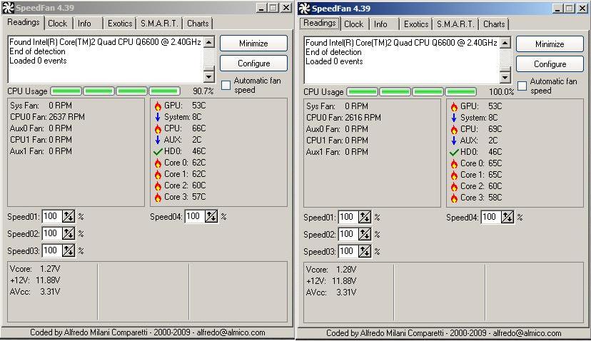

At this point i'm kind of confused =0 I got these readings for around 20-30 mins while scanning for virus's at 100% load. Now I really doubt it is a heat issue from these =0 they are way higher then possible? Could my Speedfan be off? Does it "predict" temps? I'm lost at the moment heh, any ideas? I am currently waiting with a Trojan/virus post up if that is the issue. The computer never stuttered or slowed at any time. The side of the case heated up as well. This is all with the side panel ON and no fan on it.

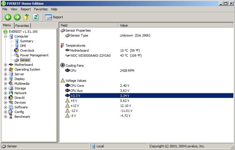

go here and download Everest Home Edition 1.51...launch it and click on the + beside computer...click on sensor...get a screenshot and post it for us...

Here is the sensor tab. I believe there is another one earlier in the post, but I do not remember.

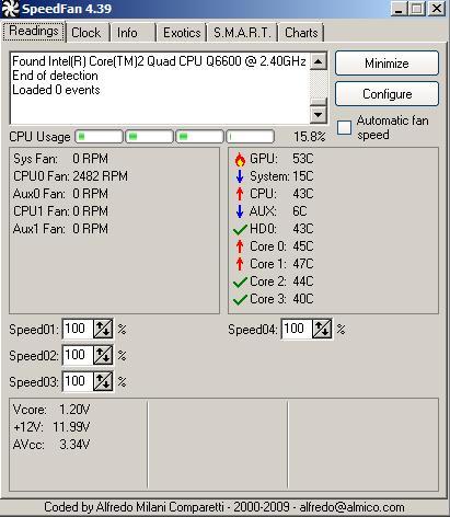

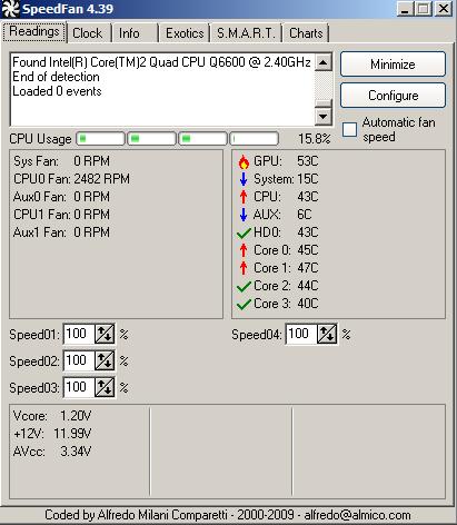

Something HAS to be off somewhere this is what i got with speedfan while posting this??? My temps have never been as low as 40-43C while streaming Hulu video... In the past weeks with issues they have been 49-52 while doing the same. Is it possible its a virus, or I have a corrupt version of speedfan? I have been back at the PC for around maybe 20 minutes and the CPU0 Fan is stuck around 2300-2500 which in my opinion is GREAT lol. Is this a bad thing at all? I don't care the smallest bit about noise even though it is making none whatsoever.
