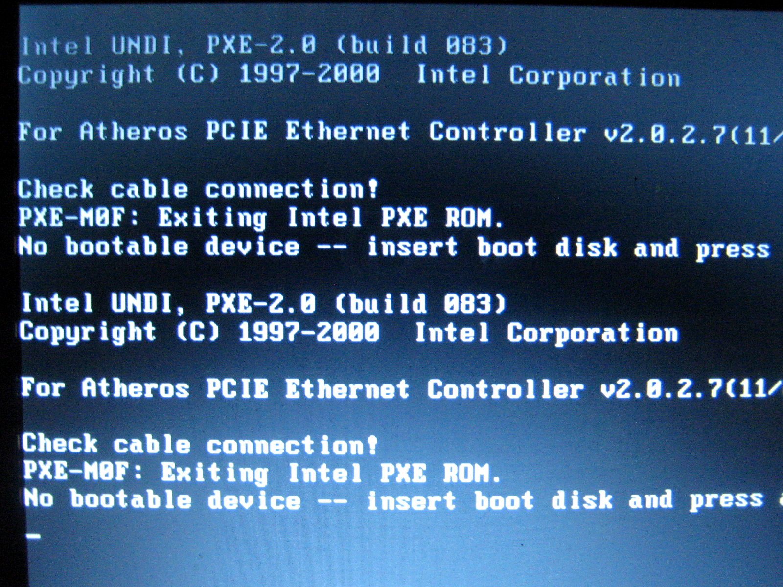

By the Way this is what my computer says
Intel UNDI, PXE-2.1 (build 082)
Copyright © 1997-2000 Intel Corporation
For Atheros PCIE Ethernet Controller v1.0.0.5(01/22/09)
Check cable connection..!
PXE-E63: Error while initializing the NIC
PXE-M0F: Exiting Intel PXE ROM.
No bootable device -- insert boot disk and press any key
Please help me, thanks!

It looks to me like your Western Digital hard drive is dead Legobot, but quite why the optical drive is listed as a Network boot is quite baffling when it should be listed next to IDE 1

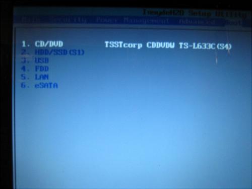

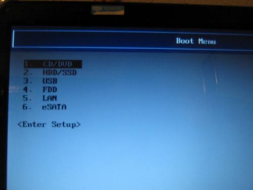

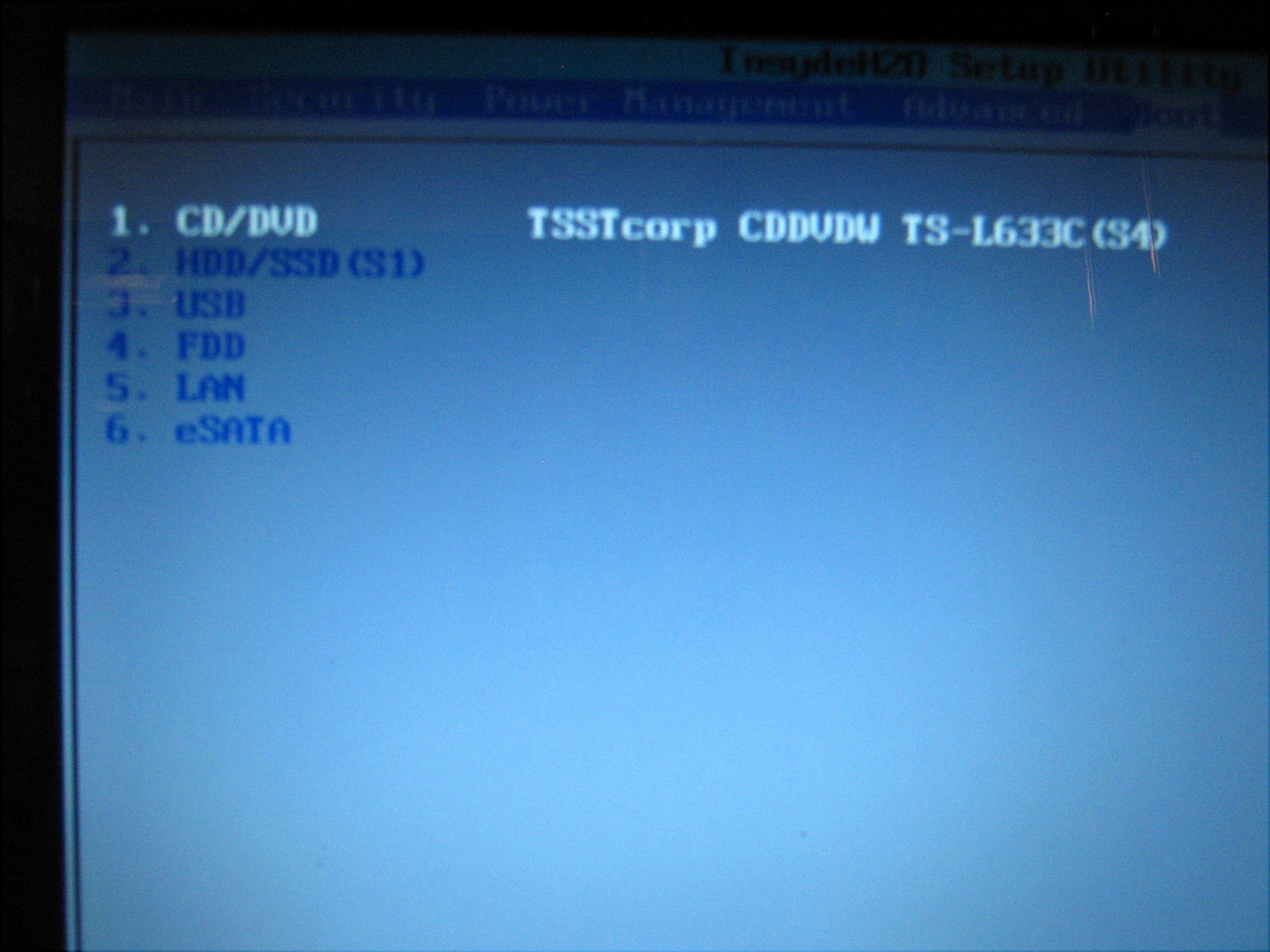

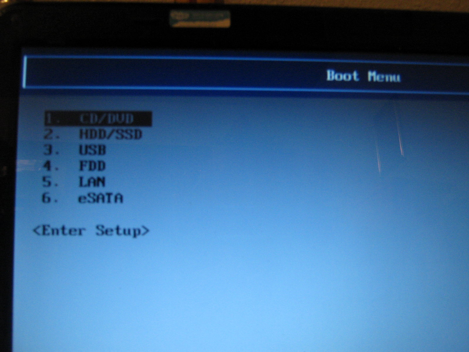

Totally confused. I have the exact same problem. I've read this topic & another, both similar prob & close to same solution. I've attempted to the best of my ability to follow thru & when finally getting to BIO's, changing to make things go: CD, HDD, USB... I even found the boot disc made when I 1st got the pc. This is like the 3rd time since owning our Toshiba Satelite L655 this has happened.
Previously I was able to resend to Toshiba, 1st yr. but now it's 3 yr's, no back up plan. I even attempted to put HGT??? on a cd using my OLD HP, slow but pretty reliable $80 pc I got off Ebay earlier this yr :D I even gave the bottom right hand side below the number pad a lil thud, as suggested on another thread here on Geeks Go.
I use the Toshiba because it's obviously faster for posting Ebay auctions, researching items I find out & about, etc... While I've been looking for an excuse to upgrade now to the pad world, to eliminate some wasteful buys, fixing the Toshiba is not my 1st.
What worries me, is if this can't be fixed, I don't have a OS to download onto a new hd.
TY
