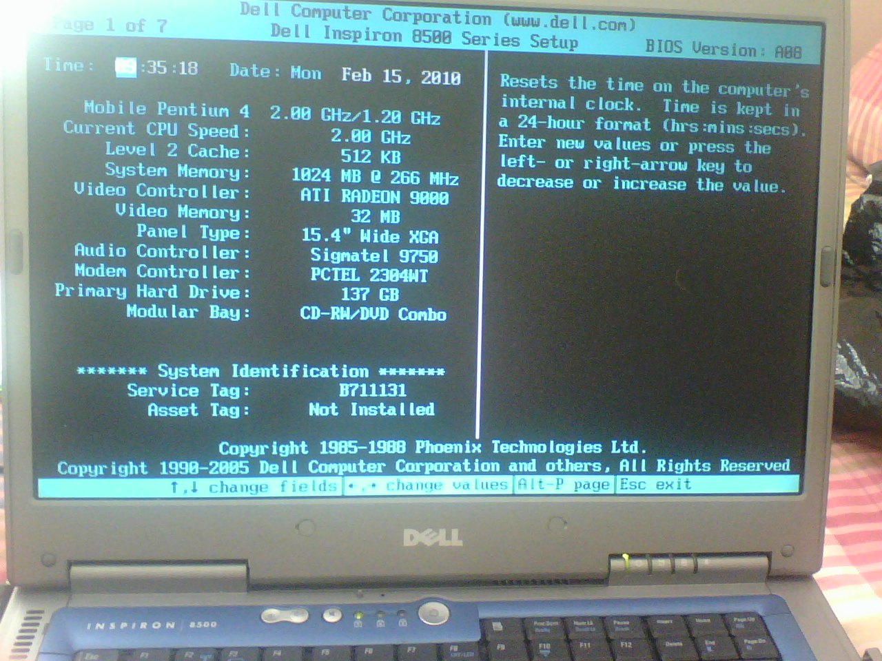

OK is there any way to get a pic of the first bios screen so I can instruct you?
Depending on who makes the bios will determine how it auto detects the HD.

Here is the first Bios page. I can send more if it would help. Cheers, Jim

OK I see where it has 7 pages total. Have you gone though all 7 pages and checked for anything about hard drives, hardware, auto detection?
Also how old is the system itself?
I think I know the problem but let me know the age so I can verify.

The system was new in July of 2003. I looked through the pages and don't see anything about hardware, hard drives, or auto detection.
#40
I'm wondering if your bios won't see anything larger then a 130 or 150 drive.
Is there anything in your bios about LBA ?
As much as I hate to admit it the issue is the drive not being identified correctly.
Is there another system you can hook that drive into as a slave and see if it is identified correctly then?
That would tell us for sure if it is a drive or your bios that is causing the issue.

I've been through all the seven pages, and could not find anything about LBA. There was a reference to it on the back of the hard drive, "Drive Parameters LBA 488397168 250.00GB" but not in the Bios. Keep in mind that this drive worked great for nine months. I don't know whether the bios identified the Primary Hard Drive as 137GB, or 250GB when the system was working, but it worked fine.
