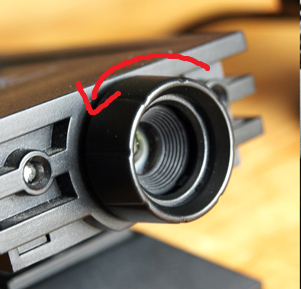

I think I might have a solution for you all:
Try turning the focus wheel of the eyetoy (around the lense) all the way counter clockwise and then plug in the eyetoy.
After I did that, Windows recognized the eyetoy instead of showing "Unknown device".
After that just install the right drivers according to the instructions online.
