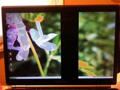

The problem:
-Black bar appeared vertically across the screen, and all colors instantly became distorted (As if I'd used a filter on a picture). It looks similar to a negative image/reversal of colors.
I've tried:
-I ran a full virus scan (took hours), I restarted it, I put it into hibernation and 'woke' it. Still have the same problem.
-It's not the screen resolution as my cursor can access both sides of the black bar. I can drag windows through the bar to either side of the screen.

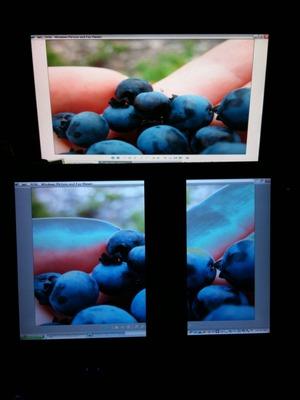

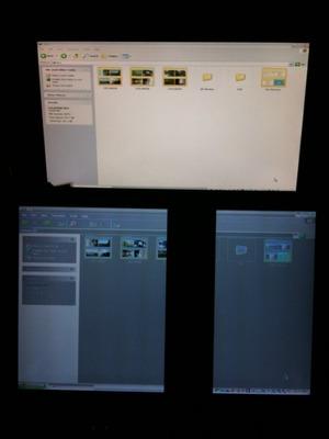

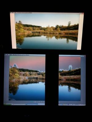

Thanks for your reply and your friendly greeting. It seems it's a problem with the laptop screen.
When I display on both the laptop and desktop simultaneously, the difference between the two screens is striking.
I've added photos. The top screen is the feed from the VGA port (Normal), the bottom screen is the laptop (Abnormal).
Is there anything I can do to fix it? Should I bring it in for repairs? If I leave it the way it is and keep using it, can it get worse?

Hi 5emini, you are welcome and thank you for the photos :thumbsup:
This may be a problem with the motherboard to screen display cable/ribbon as they can come loose or
become damaged from nothing more than opening and closing the lid of the notebook, can you provide us
with the exact model number of the Qosmio so we can do some research, it may be something like x770
or x870, just so you are aware repairing a notebook is not a task that the average user should attempt
so unless you are confident enough then yes you may require the services of a local tech, our research findings
should help you decide which you want to do.

You have a number of issues going on here that will require a partial dismantle of the notebook, see below;
It doesn't always recognize that it is plugged into the wall. I have to jiggle the connection (where the cord meets the back of the computer) to ensure that it is getting power
If the power jack has come away from the MB it will cause various problems such as a system short and overheating.
The battery will go from 100% full to an immediate drop to 3%, even though it is plugged in the wall outlet. It is never used on battery power alone. (This machine is huge and heavy, so I basically use it as a desktop.)
The battery and AC adapter should not be used together for long periods of time as it will bring the battery to a premature end of life which is partially what you are seeing now.
The display issue is a well documented one http://www.laptoprep...chip-repair.htm
An example of what you may need to replace http://www.ebay.co.u...=item2570d9ed07 (video ribbon only though)
