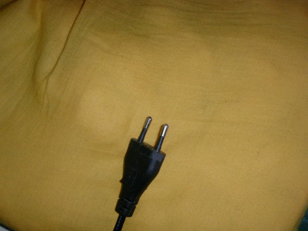

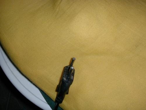

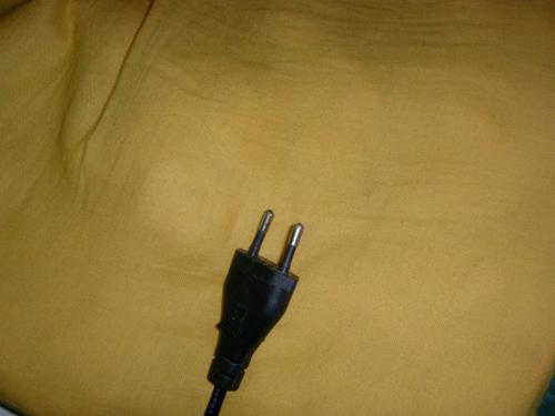

Look at these pictures, I hope you can see it
I see burnt ends badly if that is what you mean.

  • 210 posts
Yes, exactely :thumbsup:
OK and this is still what you are using to power your system?

  • 210 posts
Yes, rshaffer61 with the adaptor power from the manufacturer, of course.
Edited by ramaflore, 17 August 2012 - 12:58 PM.
Ok then I suspect replacing it and trying to get a safe outlet to use. If that is not possible then you need to get a surge protector that will protect your system.

  • 210 posts
I have on surge protector but I had also little sparks when plug in, that's the problem. I bought also another one, and the same problem occured.
Do I need to replace the entire adaptor power or only the cable with the outlet ?
