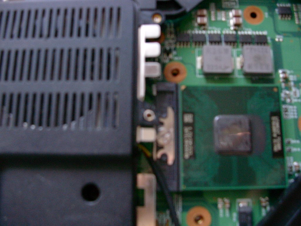

Look at the right size near the CPU, a sort of puddle, I couldn't remove it. It's like it was recover by transparent plastic. Nevertheless, I could remove the thermal paste on the CPU heart.

That would be nice if all this time the heat was the issue. As far as the thermal paste if you didn't clean it off the CPU it should still make contact with the heatsink. Though not as good as it should be. If you did remove it from the CPU I would suggest being very careful as the heatsink is not going to make a solid contact which will result in temps not being low like they should.

That puddle is probably from the thermal paste that seaped out over time. The adapter as I stated before you may not be able to get enough power through the adapter going with a lower rating like you are talking about. Do you have a laptop store around you that maybe you can ask if it would make a big difference to use the 65watt one versus the 90 watt one?

If this puddle was made of thermal paste (it was my first feeling), why I couldn't remove it with my fingers ? It was like a transparent thin film, is that normal ?
Do I need to remove it ? On the CPU hear (in the middle) there is no transparent film.

You shouldn't have to worry about the film. It is possible it is a protective film on that part of the CPU that is not meant to be removed.
If it is possible a clearer picture would really help me to determine what it is. ;)

No problem I will try get a clear picture for tomorrow morning. If I'm to close, the picture is too blurred and if I'm a little bit far away, the picture will be smaller.
#45
Do you have zoom on your camera? That way you can be farther back and get a clear closer picture.
