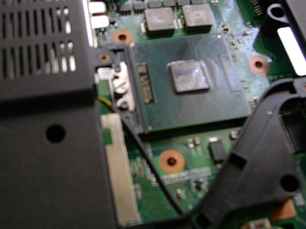

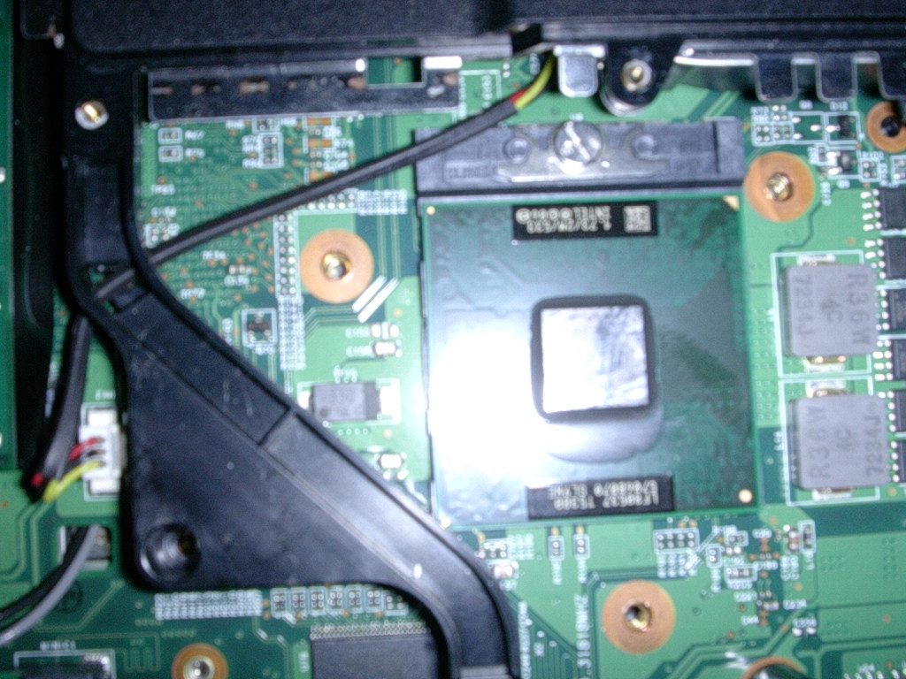

Look at these new pictures, hope it can help you.
Save these pictures, you will see it better ;)

Yeah it doesn't look like anything to worry about. Just make sure you have thermal paste on the little square where the heatsink attaches. It won't take much so don't over do it. You just want to make sure it has a good connection between the heatsink and the cpu. :thumbsup:

Ok, nice explanation.
Do you have any brand names that you can recommend it as thermal paste ?
#51
They are all pretty much the same and it depends on where you would buy it from. When I buy I usually buy what ever the manufacturer suggests or Silver. :thumbsup:

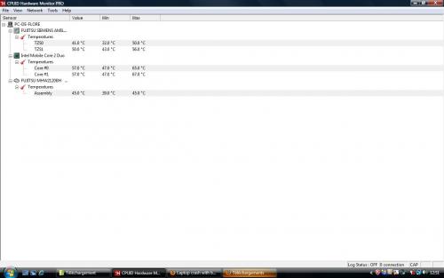

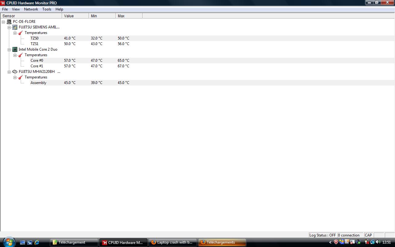

Look at these CPU temperature, let me know your opinion.
#53
They look good now but the important question is how does the system run now?
