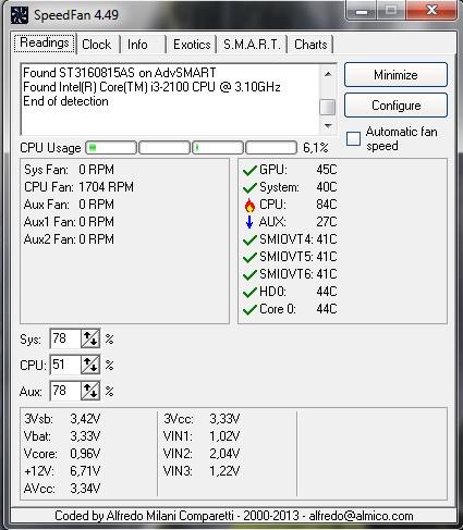

Download Speedfan and install it. Once it's installed, run the program and post here the information it shows. The information I want you to post is the stuff that is circled in the example picture I have attached.

BTW, a friend of mine suggested that I should try removing the M/B battery, so as to observe whether the beeps will continue...is there any point in that suggestion?
  • 25,095 posts
The Speedfan results show your CPU temps to be high and the PSU voltages are not right.
The safe footprint for the CPU is 69.1 http://ark.intel.com...-Cache-3_10-GHz)
Turn off the computer and let it cool down, restart the computer, go into the BIOS and restore the MBs default factory settings, save and exit.
Run HWMonitor and provide a screenshot so that we have a comparison to the Speedfan results http://www.cpuid.com.../hwmonitor.html

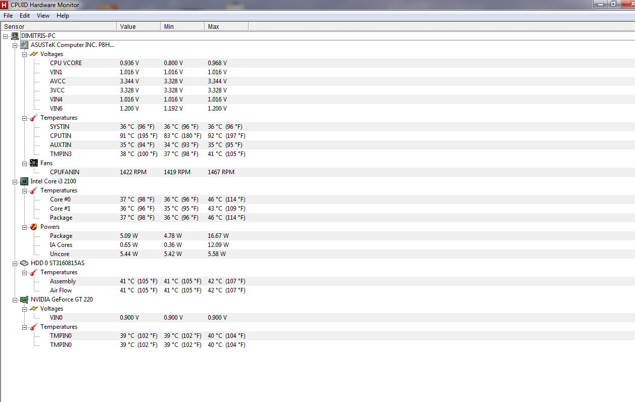

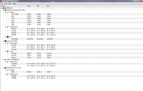

Done...
  • 25,095 posts
Thanks for the update :thumbsup:
Were all suggestions completed.
Your CPU temps are still too high and we are still not getting all of the voltage readings that we need so we must try something else;
