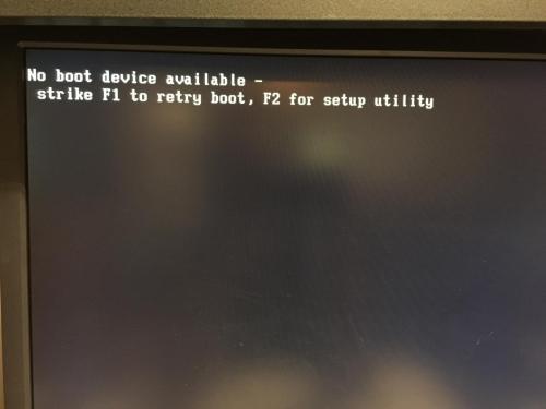

The other day my computer started acting up ... I turned it on and got this ..
After freaking out and staring at my monitor for like 10 minutes I decided to click on F2 and went to the boot sequence .. I noticed that it was changed and they all said "not present" EXCEPT the one that said "Onboard or USB CD-ROM drives" so i clicked on that one and moved it up to the top, saved and rebooted ...

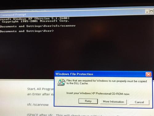

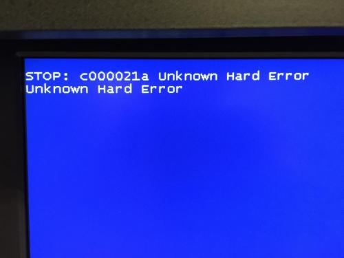

I got a blue screen didn't take a screen shot of that one because at this point I was hyperventilating that instructed me to do a full scan on next restart to check all drives and files .. after it was done it found something and it asked me to fix it all with all other options so i clicked on "fix it all"
I did a hard shut down and got this screen again ...
So I was able to change it again to where I can put my "Onboard SATA hard Drive" (which before said not present), saved and restarted .. started up smoothly

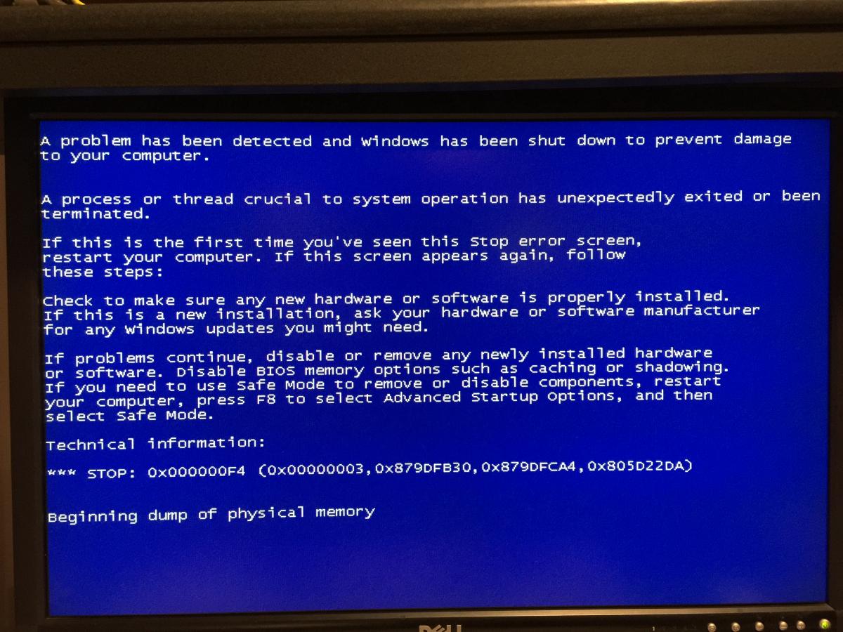

After using it for a bit i got the blue screen with this
I think this was the sequence of events and i hope this is helpful to anyone who can help me.

Doesn't look like a virus to me.  More likely your hard drive is failing.  Are you able to boot now?  If so:

Following hard drive errors are shown in Speccy:
Even tho they say Status Good they are not.  Normally the raw values would be 0 on a good drive.  The one in red is really bad.  Over 1200 sectors are so bad that they can not be read and have been blocked from use.  I think your drive is dying and you need to get a second drive and clone the old drive to it before its too late.

    I'm thinking Seagate is having quality control problems.  Your drive didn't look that old which is why I asked if it is still under warranty.  Isn't there a 2 year warranty with Seagate drives?
    Can't tell if you have lost anything.  We can run a disk check and SFC and see if most of the windows files are still there:
    Click Yes to schedule the disk check, but don't restart yet.
    Right click on (My) Computer and select Manage (Continue) Then the Event Viewer. Next select Windows Logs.  Right click on System and Clear Log, Clear. Repeat for Application. Reboot. The disk check will run and will probably take an hour or more to finish.
    Start, All Programs, Accessories then right click on Command Prompt and Run as Administrator.  Then type (with an Enter after each line).
    sfc /scannow
    (SPACE after sfc.  This will check your critical system files. Does this finish without complaint?  IF it says it couldn't fix everything then:
    Copy the next two lines:
    findstr  /c:"[SR]"  \windows\logs\cbs\cbs.log  >  \windows\logs\cbs\junk.txt
    notepad \windows\logs\cbs\junk.txt
    Start, All Programs, Accessories, right click on Command Prompt and Run as Administrator, Continue.  Right click and Paste or Edit then Paste and the copied line should appear.
    Hit Enter if notepad does not open.  Copy and paste the text from notepad into a reply.  Close nOtepad.  Close the Command Window.
    and save it to your Desktop:

    Hi I am still working on post #7 of the instructions .. trying to catch up .. I am up to the part where I am asked to do the "command prompt" but i font see an option to use as "administrator" I am however the only user on the computer and believe my account is the administrator account.
    So I typed in sfc/scannow anyways and keep getting this >>>
    What do i do next?  Do I continued on to the next step because I have no idea what cd or what to do next ..
