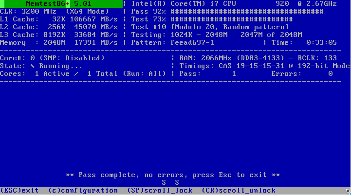

I ran that memory test for about an hour yesterday. How to you know if it's working? There's no spinning wheel, no progress bar, no percent complete. It just sits there. Anyway I gave up.

to be honest i wouldn't try any other os until you can figure out where the problem is with your laptop.
when you ran memtest it should have looked like this :-
top right shows the pass % of current run through of all tests in a pass.
line below that shows current test pattern %age completed.
bottom line on the right shows the number of passes completed so far with the number of errors found, if any, next to it.
notice where it says state: the \ should be revolving with it saying running next to it if the memtest is working,
so besides everything else changing you should know if it is actually checking your memory and working correctly.
if when you run memtest those things don't change/happen then there is a problem and you'll need to find a different way of running the test.
ie. download memtest from here :- http://www.memtest86.com/technical.htm
then use rufus to put the iso onto your usbstick and boot it.
once you have confirmed you have no memory problems then you'll want to check your hard drive for problems.
:popcorn:

Yes. That's the page that comes up but after an hour, the is no indication that it is running. I think there should be a percent complete showing after an hour. Right?

if the memtest was working then i'd expect you to see it doing something immediately even if it was just showing it's state by the rotating / sign and it saying running, after an hour i'd expect to see some %age progress showing too, maybe even 1 pass completed.
so i'd suggest using the link provided to download memtest and create a bootable usb stick with the iso and try running the memtest from that.
