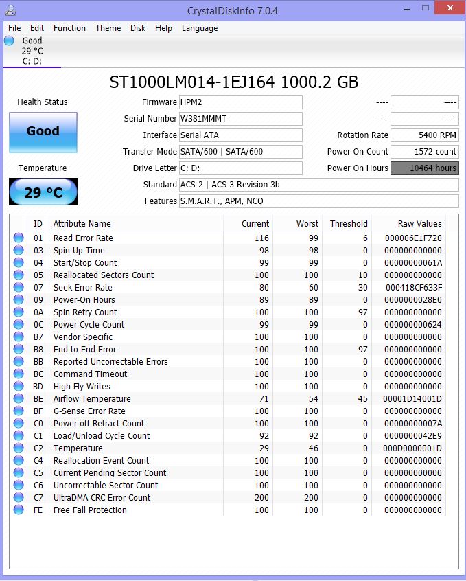

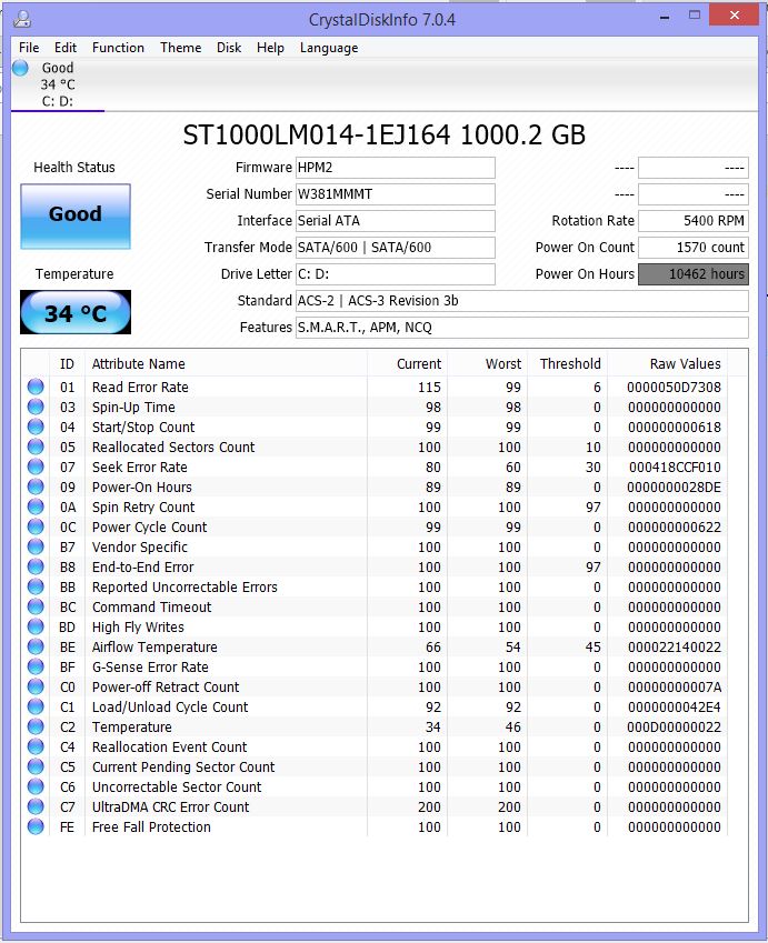

Apologies, it's been a rough couple weeks. I've been having a difficult time getting on the computer, much less trying to do any graphics work. But I have at least taken some screenshots with CrystalDiskInfo although I don't know that it will help though since I haven't been able to actually do anything more than a little web surfing and checking my email. My computer has been behaving for the most part, but I don't think that the issue has resolved itself/gone away.

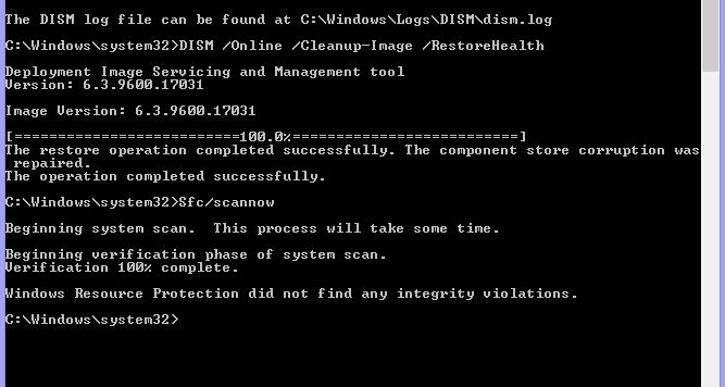

DISM log is too big to upload. Sfc/Scannow didn't find any integrity violations DISM_Sfc_Scannow.JPG

OH! Screenshots!
  • 25,095 posts
The three screenshots show that your 1TB Seagate HDD is fine for the most part but also that it suffers from high temps, this will affect performance and when getting overly hot the drive will lock up, for now, can you run Crystal Disk on the WD Red 4TB NAS HDD and post the screenshot/s for us.

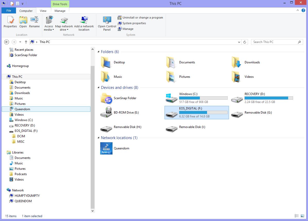

As far as my NAS is concerned, it's always on. It's a wireless network drive. I don't know why it would show up on Speccy or CrystalDisk? I think you may have misunderstood or misread? It's a five bay Network Attached Storage device. There are five harddrives in it. Synology DS1513+
DisabledDork
DisabledDork
  • 12 posts
Perhaps this image will shed some light on what I'm trying to say about how my storage device is attached and why it wouldn't show up on Speccy and CrystalDisk.
It is listed under "Network Locations".
I have it mapped as a network drive, but it doesn't show up as a separate storage drive. I would attach screenshots for Speccy and/or CrystalDisk except that they won't show anything new that they weren't showing you previously.
Please advise how you'd like for me to proceed.

This thread needs picking up and shaking down as it is all over the place, your thread title "My HP Envy is Nothing to be Envious About - SLOWER than an Abacus" is absolutely nothing to do with diskstations or network problems while it is highly probable that your latest issues are!
