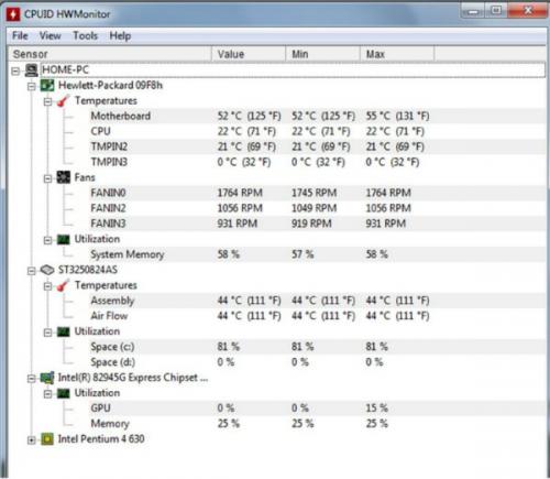

Download, run and grab a screenshot of HWMonitor (free).
Waste of Space
Waste of Space
  • 77 posts
  • 25,095 posts
Was that all of it, looks like the bottom part is missing.

  • 77 posts
Yes, Phill, that was all that was showing.  (I cropped off the empty space below it.)

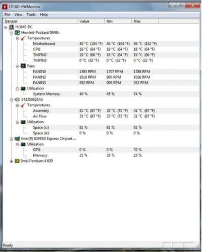

Here's an HWmonitor scan result from just a moment ago (and many thanks for your help, by the way):
Edited by Waste of Space, 25 April 2020 - 06:02 AM.
  • 25,095 posts
No problem, brand name BIOS never give much info.
Please leave opening up the PSU, they can hold a charge and are not intended to be user serviceable, did you happen to have a sniff around the back of the PC where the PSU blows out the hot air.
The motherboard reading of 56C is normally related to the CPU temperature sensor on the MB (Tcase) and if that reading were correct you would expect the CPU temp to be higher.
