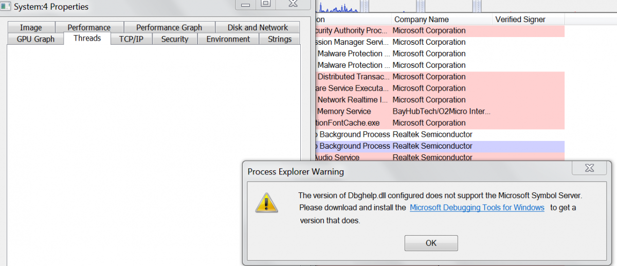

Sorry didn't catch that KernView only ran on XP.  Use Process Explorer instead.
 Get Process Explorer
 Click on System then right click and select Properties then Threads and it should show you what is running in System.  They should be sorted by CPU use so the big users are at the top.  You can select one then hit Module and it will tell you what driver you are looking at.

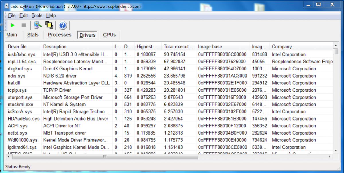

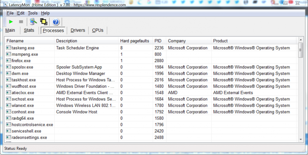

Here is the result from Latency Mon 7.0
Note unable to get a result from Process Explorer - see attachment
Attached other information from Latency Monitor
Also attached NT Kernel snapshot.  Not taking up a lot of CPU but running constantly

  • 24,731 posts
You are barking up the wrong tree with NT Kernel & System.  It's always running on a Windows system.
Latency Monitor shows major problems with some drivers.
You probably need to update Intel® Rapid Storage Technology driver
https://downloadcent...r?product=55005
Download the one that says: SetupRST.exe
Save then right click and Run As Admin.
That's the newest one available for Win 7 64 bit
Does it work or does it complain?

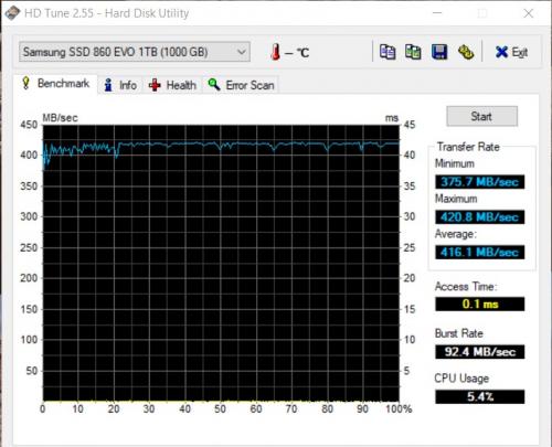

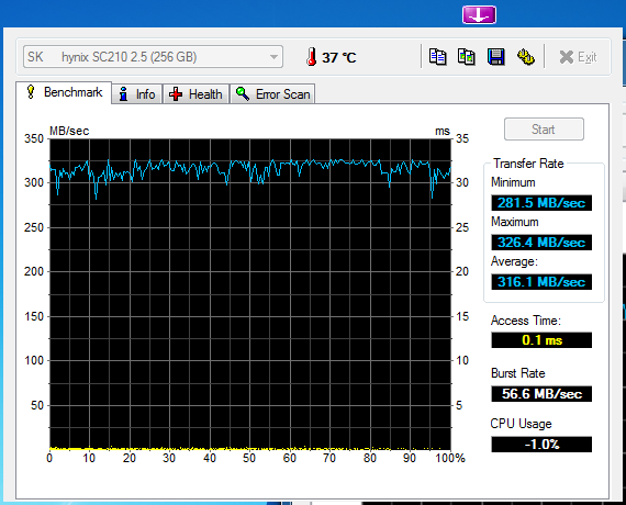

I appreciate you taking a look at this.
Two questions before I begin.
I ran an alignment program (This computer is a SSD) https://www.partitio...on-manager.htmland it showed that my disk is out of alignment.  Should I let it align the disk before I begin the recommended suggestions?
The reason I was concerned is that I have another identical computer with a hybrid 500g hard drive.  And while NT Kernel is in task manager, it is not always constantly going from 00 to 01 CPUS like the computer I am referencing.  So I was wondering what is causing it.
Edited by joseph456, 24 November 2020 - 01:46 PM.

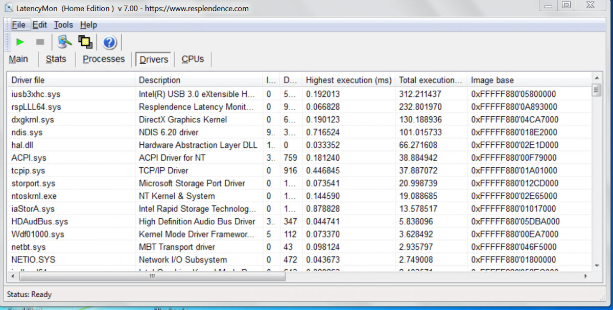

RST update (14.8.16.072) worked well - Thanks!  I have tried updating it from Dell previously but it would fail because it said it needed Net Framework 4.5 which was already installed.  This update that you suggested worked.
Latency Monitor:
CONCLUSION
Your system appears to be having trouble handling real-time audio and other tasks. You are likely to experience buffer underruns appearing as drop outs, clicks or pops. One problem may be related to power management, disable CPU throttling settings in Control Panel and BIOS setup. Check for BIOS updates.
LatencyMon has been analyzing your system for  0:00:54  (h:mm:ss) on all processors.

  • 24,731 posts
Some improvement.
You had:
Highest measured interrupt to process latency (µs):   39739.622928
Now it is:
Highest measured interrupt to process latency (µs):   2649.783467
That an order of magnitude better but still an order of magnitude higher than we would see on a happy system.  If I run it on mine I get:
Highest measured interrupt to process latency (µs):   120.20
Also you had:
Highest DPC routine execution time (µs):              878.828444
Driver with highest DPC routine execution time:       iaStorA.sys - Intel Rapid Storage Technology driver - x64, Intel Corporation
which pointed to the Intel Rapid Storage Technology.  Once it was updated it fell off the top and left:
Now you have:
Highest DPC routine execution time (µs):              429.282956
Driver with highest DPC routine execution time:       tcpip.sys - TCP/IP Driver, Microsoft Corporation
The TCP/IP driver is a Microsoft driver so unlikely to be at fault but sort of implies that your network driver might be the next thing that needs updating.
Could also imply that something in Firefox is causing problems so just close Firefox and rerun Latency Monitor and see if things change.
Are you connecting Wirelessly or via an Ethernet cable?  Can you find an updated driver for the one you use from your PC maker's site?  If not tell me what you have and I'll look for it.

Benchmark Test: https://www.userbenc...serRun/35958270

Latency Monitor says you have a Dell Latitude E6540
If that's true there is a newer version of the
Intel USB eXtensible Host Controller DriverPOPULAR
Chipset 17 Jan 2019
available.  That one of the drivers that keeps showing up so it's worth a shot.
The link to the benchmark doesn't seem to work.  Could you try it again?
Let's check your hard drive to see if it is up to speed:
HD Tune
Actual download is at:
Download, Save, right click and Run As Admin.  Run the Benchmark test and report your min, max & average transfer times.  Ideally the graph would be flat or slightly tilted to the right.  On a bad drive you will see sharp drops.  The fewer programs running at the same time the better.  Pause your anti-virus.
This is what a good SSD looks like:
joseph456
joseph456
  • 455 posts
Benchmark Results
https://www.userbenc...serRun/35961600
HD Tune
Minimum: 281.5 mb/sec
Maximum: 326.4 mb/sec
Average: 316.1 mb/sec
How do I update the driver(s)?
Also - how can I find out if my wireless driver is up to date?
Went to Device Manager and updated Microsoft Virtual WiFi Miniport Adapter Driver
Also downloaded and installed Intel USB 3.0/3.1 eXtensible Host Controller Driver although I think it just installed the same Driver

Your SSD is a bit on the slow side but shouldn't be causing problems.  Did you get a management program with the SSD?  Often they like to be trimmed.

Did not get a management program but I have used Auslogics Disk Defrag to perform the trim.  Where else can I find one?  Also noted that there seems to be an alignment problem with the disk but as I mentioned earlier was concerned  about trying it.
