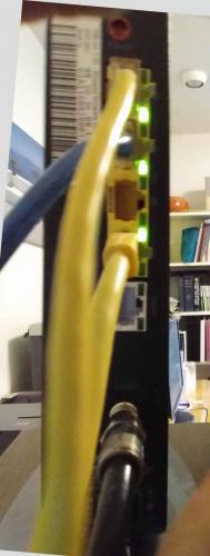

I have Verizon FIOS for my internet access and TV cable.   My current set-up (if I’m correct) is as follows:
The FIOS ONT connects via coax cable to a splitter
The splitter connects via Coax cables to the Verizon G1100 Router AND to the TIVO DVR
The Verizon Router is connected via Ethernet cables to the LinkSys VOIP device, the desktop PC computer and to the TIVO DVR
As you can see I don't have a local LAN (see attached photo).
Currently the Verizon G1100 with one Wifi booster meets all our home's internet and TV needs, however, to save the Verizon router rental fees I want to purchase a router.
It appears I need one that has an input Coax jack - UNLESS there is an Ethernet work around.   Please offer up some suggests on what router I should buy and how to set it up.

Thank you.  I considered that, but I also wanted to explore other, perhaps better, options.  If most routers don't have a coax jack, I'm not sure how they work.  I guess they use an Ethernet cable for both TV and Internet.  Is my setup better???
