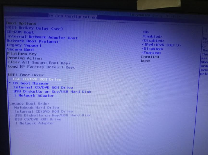

I did it, but my laptop did not boot using the USB. It booted normally. I tried it several times at different ports.

#93
DR M
DR M
    The Grecian Geek
  • 4,422 posts
Have you saved the changes you did? Usually F10 does this.

#97
DR M
DR M
    The Grecian Geek
  • 4,422 posts
Hi, Ryan.
My instructions are based on the last screenshot you posted here: http://www.geekstogo...-7#entry2659729
1. Enable Legacy support which is now shown as Disabled
2. Under the Legacy Boot Order, change the boot order so that the USB CD/DVD ROM Drive to be first
3. Save > F10
4. Restart and shut down
5. Insert the Media Tool with the Windows 10
6. Restart
7. In the lilac window that will appear, choose Repair.
8. Troubleshoot > Reset
Let me know if things ran smoothly this time.

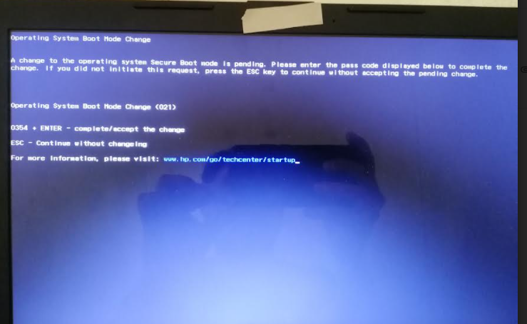

#98
rybards
rybards
  • 66 posts
Hi DR M,
It still didn't work. After enabling the legacy boot and saving it, the screenshot below appeared. I was trying to key in the code (0354 + ENTER), but nothing was showing/happening. Then, my PC suddenly went black and booted the OS normally.
Is it possible that the USB is the problem? I'm using an old USB. I just deleted its contents.
#99
DR M
DR M
    The Grecian Geek
  • 4,422 posts
Have you also changed the boot order with the Legacy Boot Option enabled?
If yes, shut down, insert the USB and restart.
(If you have the USB yet...)

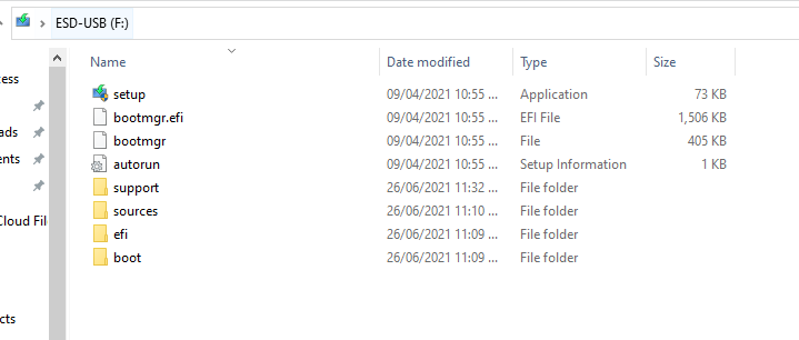

#102
rybards
rybards
  • 66 posts
Hi. No, I meant I deleted its content before creating a media tool with it. Now this is what it has after creating the tool last time. Thank you!
#103
DR M
DR M
    The Grecian Geek
  • 4,422 posts
USB seems fine.
