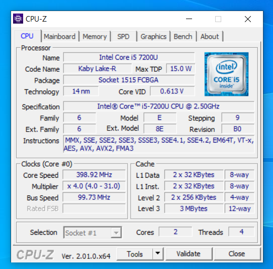

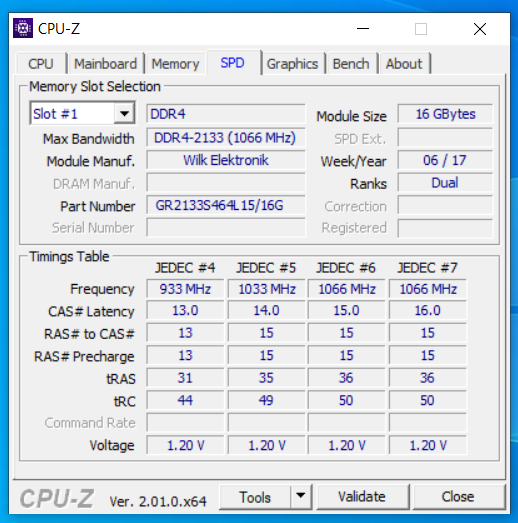

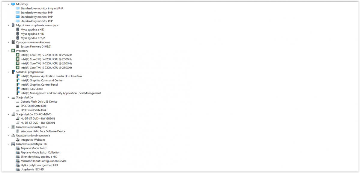

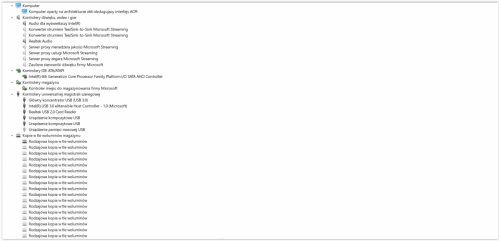

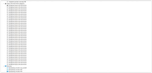

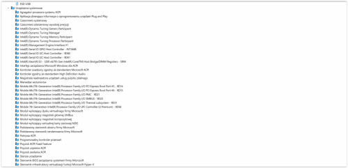

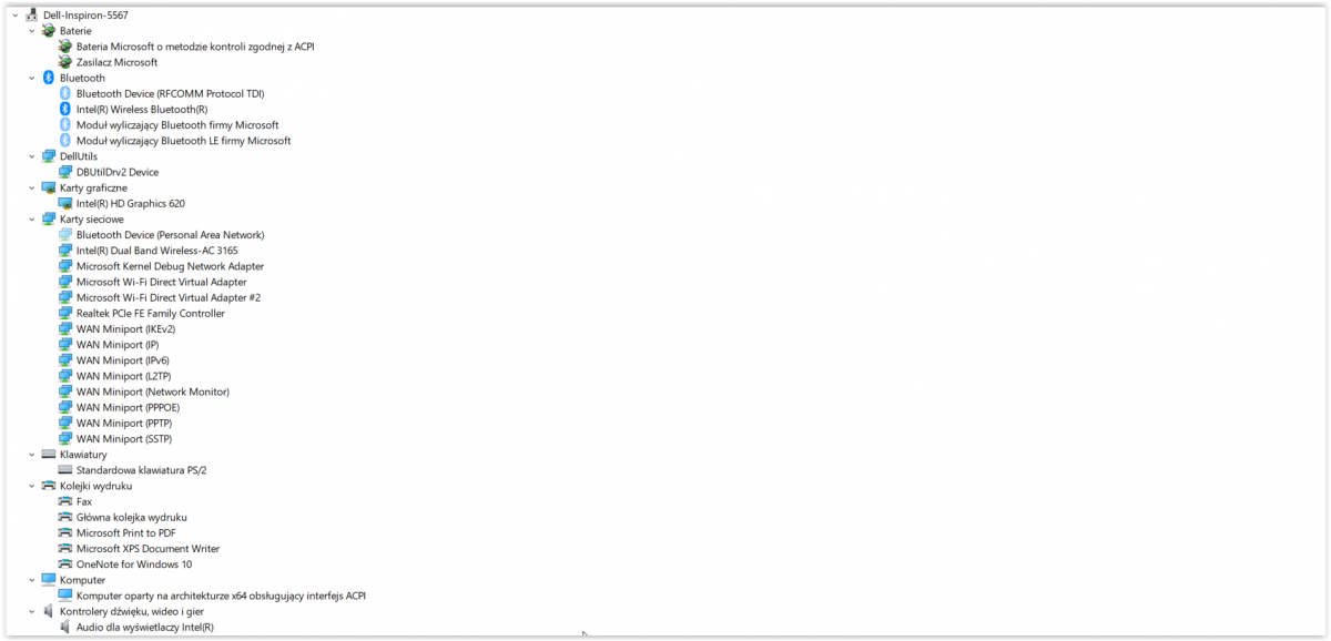

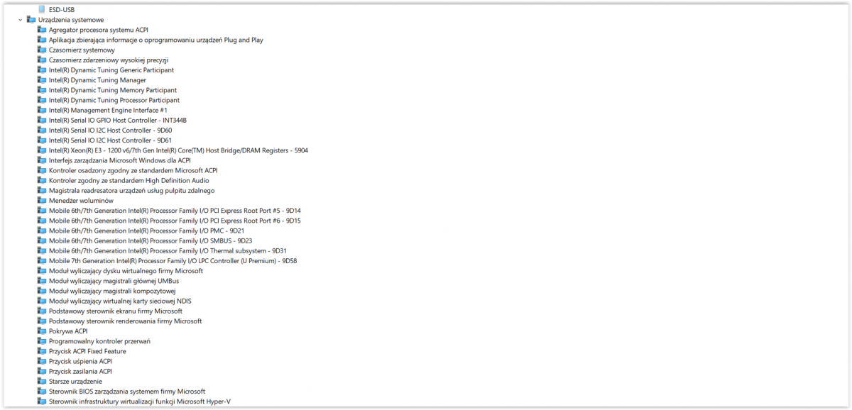

Search for: Device Manager
hit Enter.
then View, Show Hidden Devices.
Now look in the right pane for yellow flagged devices.  Right click on one and select properties then click on the Details tab.
Change Property to Hardware IDs.  Click on the top one then right click and copy.  Paste that into a reply.  Repeat for all yellow flagged devices.

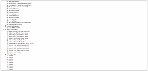

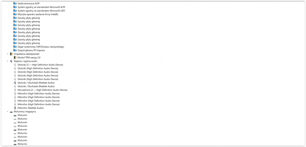

piotrzyna
piotrzyna
  • 47 posts

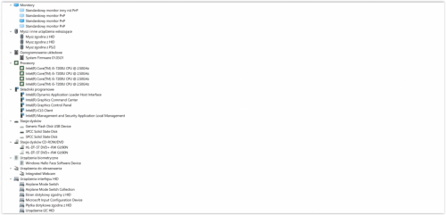

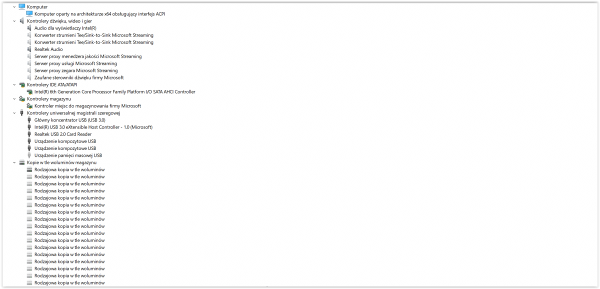

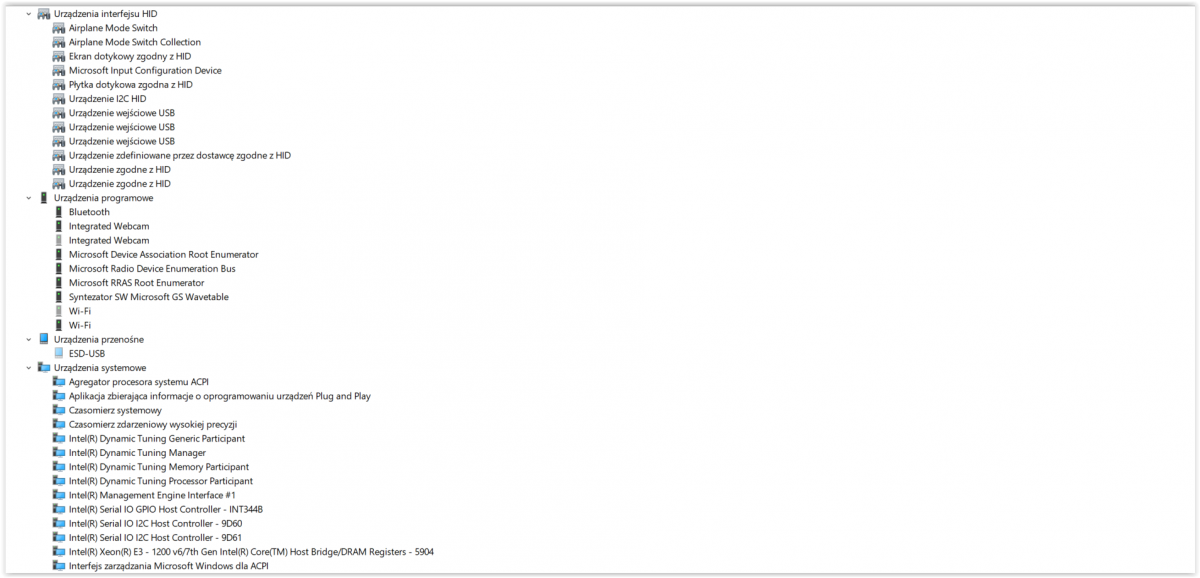

Hello RKinner.
Done and attached.
  • 24,731 posts
Doesn't look like there are any yellow flags.  Does anything say something like "Unknown Device" in your language?

I would also try the Realtek High Definition Audio Driver which should be available on the same page.  If you have the current version then just right click on the driver and Uninstall Driver then reboot so that Windows reinstalls the driver.
However normally the switching between speakers and headphone occurs at the jack via some mechanical contacts it's doubtful that this will help.
For your keyboard problem. In Device Manager:  Locate Keyboards and click on the arrow in front of it.  This will open and it should show one or more HID Keyboard Devices  Right click on each device and Uninstall Driver (Do not allow it to remove any software)  Reboot and Windows will reinstall the keyboard driver.  Perhaps that will help.  If not try  plugging in an external USB keyboard and see if that will work.  The keyboard may need to be replaced.
There should be a driver for your touchpad.  On mine it is under "Mice and other pointing devices".  Most are from (Synaptics.)  Right click on it and uninstall and reboot.  You may have to use an external USB mouse if you can't get the touchpad to work.

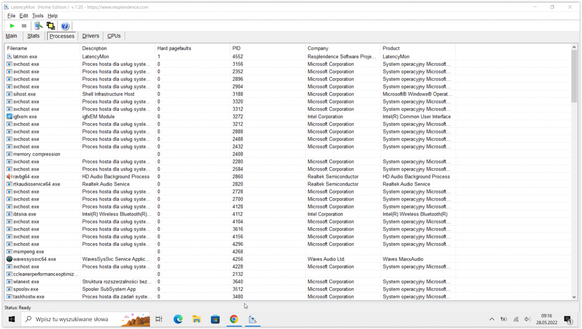

Get Process Explorer
Wait a full minute then:

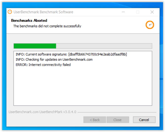

Let's get a benchmark:
Unfortunately, I can't install this.
I also tried to turn off the internet, I did a system restart
and nothing.

  5. Process Explorer downloaded, installed - report in the attachment.
  6. Speccy downloaded free version, installed as per guidelines. Report attached.
  7. LatencyMon downloaded free version, installed - report attached.

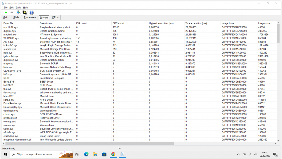

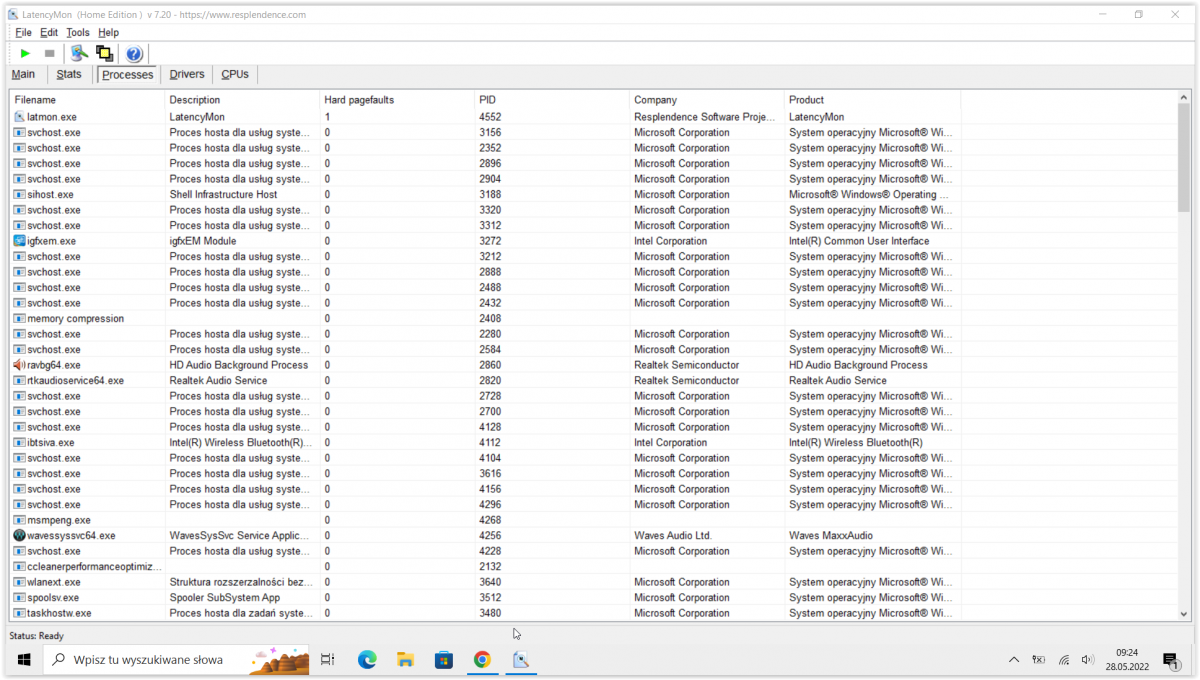

  • 24,731 posts
I see the report now.  Don't know why I didn't see it earlier.

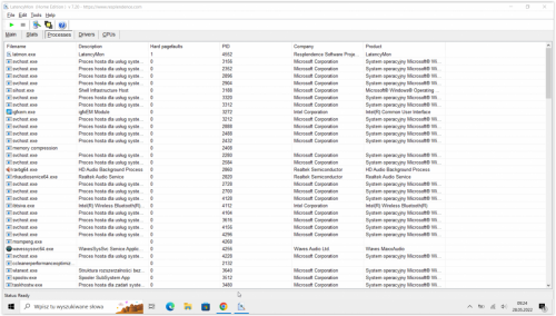

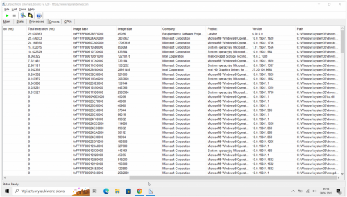

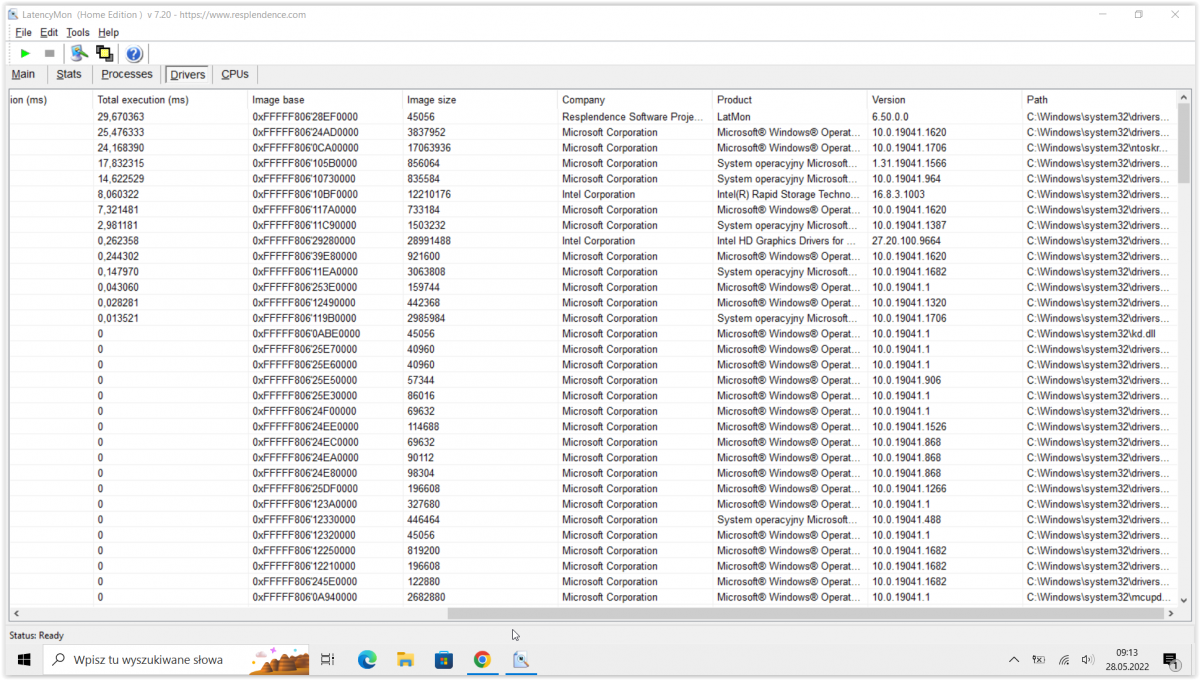

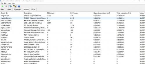

Rerun Latency Monitor for exactly 20 seconds and then stop it.  Click on the Drivers tab.  If the column labeled "Total Execution (ms)" does not have non zero numbers sorted from largest to smallest, click on the column header until it does.  Should look like this:
Make and attach a screenshot.
Now move the scroll bar on the bottom of the page to the far right and make a second screenshot.  Should look like this:
Click on the Processes tab and make a screenshot.  Should look like this:
Finally attach the latest summary.
CPU SPEED
Reported CPU speed:                                   3793 MHz
WARNING: the CPU speed that was measured is only a fraction of the CPU speed reported. Your CPUs may be throttled back due to variable speed settings and thermal issues. It is suggested that you run a utility which reports your actual CPU frequency and temperature.
Highest measured interrupt to process latency (µs):   458.088947
Average measured interrupt to process latency (µs):   9.663734
Highest measured interrupt to DPC latency (µs):       451.244502
Average measured interrupt to DPC latency (µs):       3.650889
 REPORTED ISRs
Highest ISR routine execution time (µs):              100.525442
Driver with highest ISR routine execution time:       dxgkrnl.sys - DirectX Graphics Kernel, Microsoft Corporation
Highest reported total ISR routine time (%):          0.077923
Driver with highest ISR total time:                   dxgkrnl.sys - DirectX Graphics Kernel, Microsoft Corporation
Total time spent in ISRs (%)                          0.108297
ISR count (execution time <250 µs):                   5955
ISR count (execution time 500-999 µs):                0
ISR count (execution time 1000-1999 µs):              0
ISR count (execution time 2000-3999 µs):              0
REPORTED DPCs
Highest DPC routine execution time (µs):              610.268125
Driver with highest DPC routine execution time:       nvlddmkm.sys - NVIDIA Windows Kernel Mode Driver, Version 391.35 , NVIDIA Corporation
Highest reported total DPC routine time (%):          0.068358
Driver with highest DPC total execution time:         nvlddmkm.sys - NVIDIA Windows Kernel Mode Driver, Version 391.35 , NVIDIA Corporation
Total time spent in DPCs (%)                          0.164361
DPC count (execution time <250 µs):                   9040
DPC count (execution time 500-999 µs):                35
DPC count (execution time 1000-1999 µs):              0
DPC count (execution time 2000-3999 µs):              0
 REPORTED HARD PAGEFAULTS
Process with highest pagefault count:                 latmon.exe
Total number of hard pagefaults                       2
Hard pagefault count of hardest hit process:          1
Number of processes hit:                              2
 PER CPU DATA
CPU 0 Interrupt cycle time (s):                       0.348471
CPU 0 ISR highest execution time (µs):                100.525442
CPU 0 ISR total execution time (s):                   0.086398
CPU 0 ISR count:                                      5860
CPU 0 DPC highest execution time (µs):                610.268125
CPU 0 DPC total execution time (s):                   0.120516
CPU 0 DPC count:                                      8281
CPU 1 Interrupt cycle time (s):                       0.053395
CPU 1 ISR highest execution time (µs):                4.301081
CPU 1 ISR total execution time (s):                   0.000054
CPU 1 ISR count:                                      22
CPU 1 DPC highest execution time (µs):                189.734775
CPU 1 DPC total execution time (s):                   0.001049
CPU 1 DPC count:                                      87

I launched Delay Monitor for exactly 20 seconds - I'm attaching screenshots.
PS. The screenshots you attach unfortunately don't open and are rather the same as the three included in your post.
CPU SPEED - Registry.txt report attached.
The rest of the information you described - I just opened my big eyes.
Unfortunately, I can't understand it because it's black magic to me.
I completely rely on you.
Edited by piotrzyna, 28 May 2022 - 02:55 AM.
  • 24,731 posts
No problem seen in the short 20 seconds.  Your system is actually faster than mine in the short term.  You did not attach the summary page but I expect it did not complain.
Check that the hard drive has been optimized:
Right click on C: and select Properties then Tools.  Select Optimize.  On the new page select Optimize.  On mine it only took a minute to report back that the drive was 0% fragmented.
I see your version of Intel Rapid Storage Technology Driver and Management Console is slightly older than the one on the Dell Support webpage so try and update it.
Also update:
Intel Dynamic Platform and Thermal Framework Driver
Rerun Latency Monitor for 1 minute and post the summary and a screenshot of the drivers tab.
