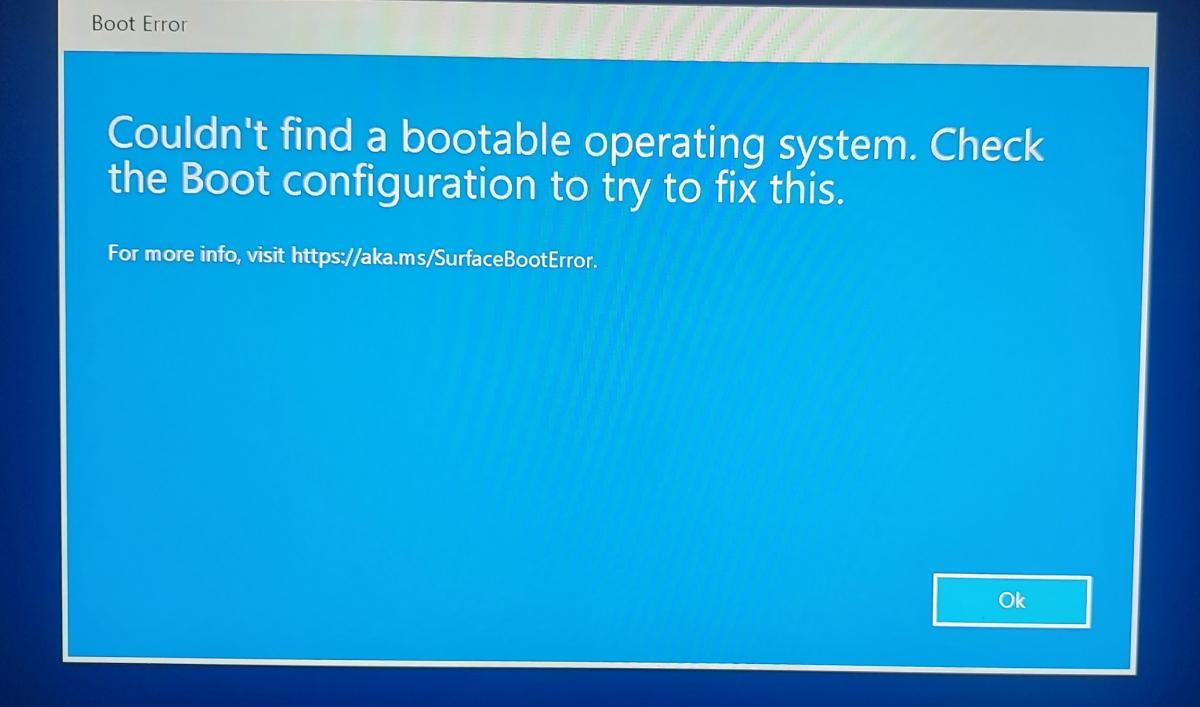

I have a brand new Surface Pro 7 Plus tablet. Had a slight issue setting it up as managed to get Bitlocker installed but didn't want this. Was eventually able to get in and disable it - this may or may not be relevant!
Now it runs fine if I turn it on from being completely switched off.

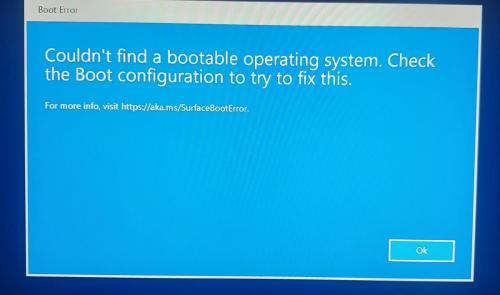

However, if I try and restart it, it goes to a Boot Error screen:
Couldn't find a bootable operating system. Check the Boot configuration to try to fix this.
For more info, visit https://aka.ms/SurfaceBootError.

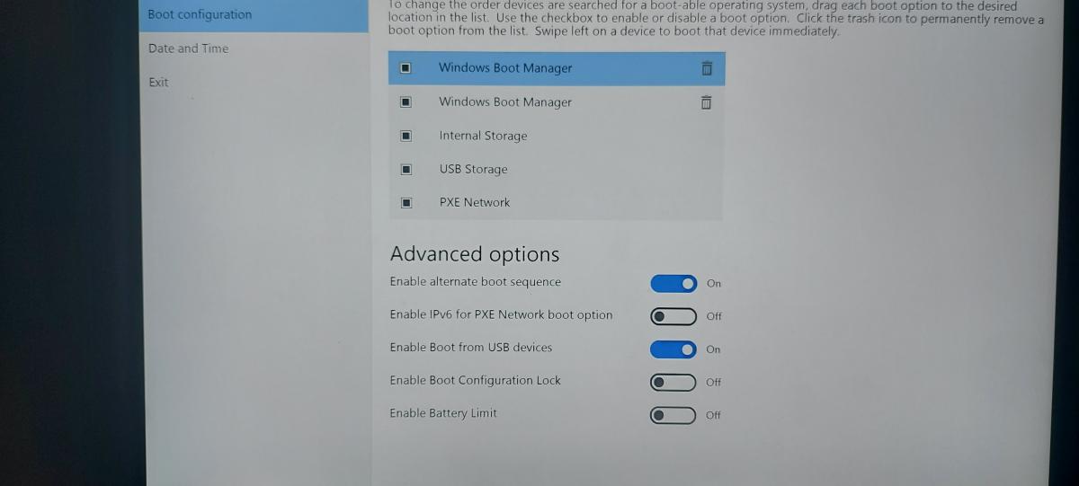

Clicking ok takes me into the Surface UEFI screen. I click on Boot Configuration and can see there are 2 Windows Boot Managers. I delete the top one (assuming that is my problem one) and then exit and restart - it then work fine and loads up Windows.
If I shut it down and turn it back on it works fine.
As soon as I try and do a restart, it does back to the Boot Error again.
I have also tried a full Windows reset but this hasn't helped.
The tablet is brand new.
Would be grateful for any suggestions!
